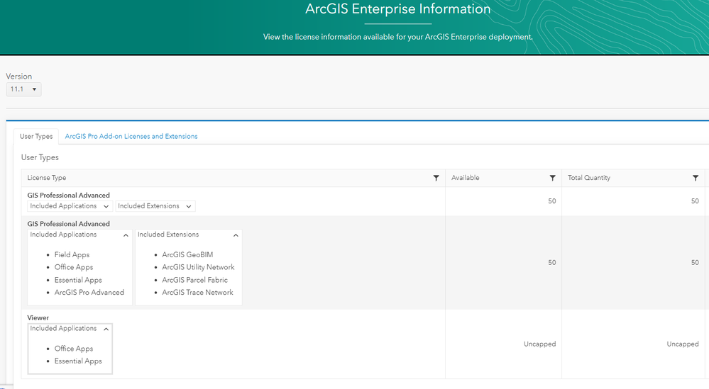

For our Portal, we have can have 2 different user types: Viewer and GIS Professional Advanced.
At least 1 GIS Professional Advanced user is required according to the Portal licensing wizard. We mostly need Viewers, but would need some with this more highly capable user type so that's fine. For what it's worth, the GIS ProfessionalAdvanced user includes the ability to use ArcGIS Pro.

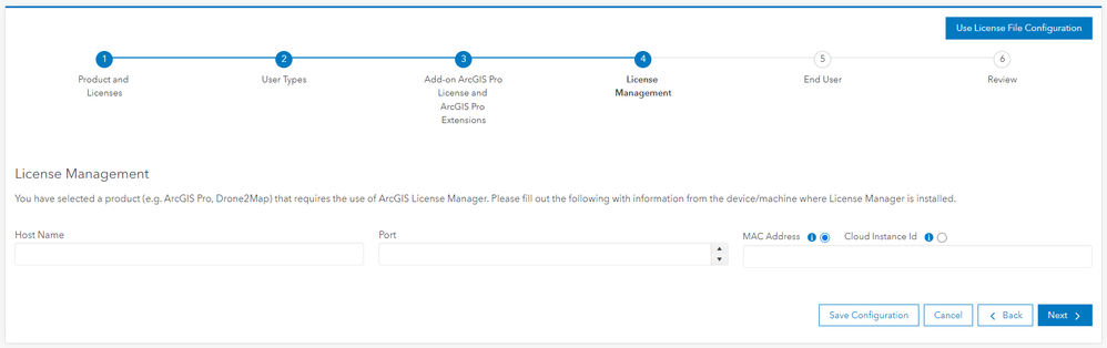

So I select the number of licenses for each user type and move forward and do not select add-ons for any other software. I'm then prompted for details for a License Manager.
When I've looked through the docs and Esri videos about setting up Portal, I've either missed or not seen anything about how the License Manager fits into all of this.
  • Why do I need a license manager if I'm creating a license file in MyEsri?
  • What licenses would the License Manager be managing that Portal can't?
I'm guessing it has something to do with licensing Pro for the GIS Professional Advanced users, but I'm not really sure. I need to be able to explain this to our IT team setting up all our servers why this additional piece of software needs to be installed and where. I've gotten ideas on where already, but would appreciate additional clarification on why the License Manager is necessary.

It appears that we only have 2 options for Portal users:
  • Viewer
  • GIS Professional Advanced
Based on my understanding of what you've written
  • The GIS Professional Advanced user is the only type of these two that would be eligible for the Initial Administrator Account
  • Since there are no other eligible User Types, we must license at least 1 GIS Professional Advanced user.
  • Since ArcGIS Pro Advanced is in the Included Applications list for this User Type, we will need to implement the License Manager.
Am I characterizing this correctly?
Thank you for sharing the additional links. I understand better why I need the License Manager, but looking am still a bit unsure of where to advise our IT team to install. Is it OK to put it on the same machine as Portal? Or does it need its own server?
MarleyGeddes
Yes - you can install License Manager on the same machine that Portal for ArcGIS is installed. It is light weight and does not require a separate server. It is the machine information where License Manager is installed that you will input when creating a Portal for ArcGIS license file.
