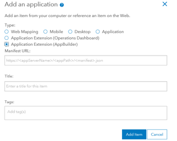

We recently needed to rebuild our 10.9.1 Enterprise system from scratch after an failed upgrade from 10.7.0 and are encountering a roadblock when trying to register a custom widget to our Portal. I follow the directions as per the Esri Add Custom Widgets document for Enterprise 10.9.1 but receive the error message "The URL does not reference an AppBuilder Extension."
I have had some concerns from the start given that the menu lacks the Title and Tags options from the example in the directions and all the examples in the various help postings and videos I've found while searching for a solution.

Looking at the image you shared, I see the URL you provided includes "inetpub/wwwroot" however that part of the path is ignored by IIS. If you have a "Measure" folder in C:\inetpub\wwwroot, can you access https://yourdomain.com/Measure/manifest.json ?

No, I am not.  I only get a HTTP Error 404.  Is there a setting I need to change to make the file location network accessible?

I noticed that the widget URL shown in the screenshot look a bit interesting. The easiest way to get the correct URL is to try to select it from IIS content view, then right click and choose "Browse". This should open the file in the browser, you can then use the URL to register the widget with ArcGIS Enterprise.

Thank you IhabHassan, that was the sticking point.  I used Browse as you advised and the resultant URL was a truncated version of what I was trying to use.  As TonyContreras_Frisco_TX's post mentions in a wonderfully concise way, the portion "inetpub/wwwroot" in my path was gumming up the works.  I replaced localhost in the browsed URL and Portal accepted the entry.  Thank you both!
