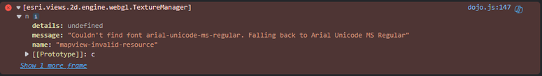

This is the error from Dev tools in Edge:
My theory is that the browser can't render the character for some reason due to a conflict with the fonts. I am not sure if the browser looks for the font locally or if it references a ESRI hosted font via network.
I am wondering If it is an internal issue, and I should mitigate with internal IT or if it is something on ESRI side of things.
I've tried replicating the symbol on an AGOL map and it renders the label fine using Edge. It comes up with the same error as above but it substitutes the font successfully.
