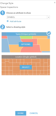

Just a suggestion for a possible enhancement:  Within the webmaps feature layer Change Style dialog, perhaps a way to "Fetch Feature Layer Symbology".  Like, an additional option here:
Thanks, Again
