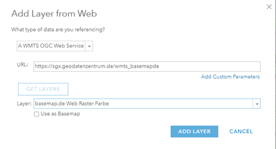

We want to add a WMTS service (https://sgx.geodatenzentrum.de/wmts_basemapde) within Map Viewer. We are currently working with Portal 10.9.1.
We have added https://sgx.geodatenzentrum.de as trusted server. And we can add the WMTS as content. But using the same WMTS url in Map Viewer brings up a service error "The layer cannot be added to the map."  The same WMTS url used with  Portal 11.0 Map Viewer works also fine.
Whats wrong here?

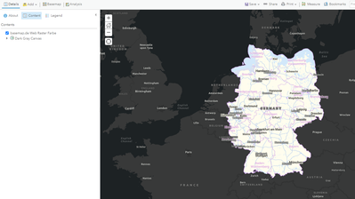

The workaround I use in our 10.9.1 Enterprise Portal is to:
  1. Open the map in Classic Viewer
  2. Add the WMTS layer(s)
  3. Save
  4. Re-open in the new viewer
  5. Save
So far that has worked well for us. I suggest doing this process first thing to avoid incompatibilities when switching between the new and classic versions.

I'm afraid the ability to add OGC WMTS/WMS/WFS layers from within the new Map Viewer is not available in Portal 10.9.1. It's only possible to add these in Map Viewer Classic at that version. As a workaround, it should be possible to add the WMTS using Map Viewer Classic, save the webmap, then open that webmap and view the WMTS using Map Viewer.
The following is taken from the Portal 10.9.1 documentation:
  • OGC WFS, WMS, and WMTS layers are supported in Map Viewer Classic.
  • Maps that contain OGC WFS, WMS, and WMTS layers can be added to Map Viewer for display purposes only.
This limitation was addressed and the capability is available in both Map Viewer and Map Viewer Classic in Portal 11.0.
From the Portal 11.0 documentation
  • OGC WFS, WMS, and WMTS layers are supported in Map Viewer and Map Viewer Classic.
I hope this is helpful
