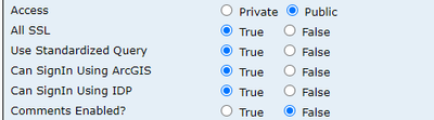

Esri Support created the following technical article for for the workflow you are describing. If you do not have an administrator SAML account you can use to update the value in Portal home, changing the "Can SignIn Using ArcGIS" value to true via the self page will enable built-in logins again on the signin page.

I'm stuck and unable to log into our portal using a built-in account. I followed the instructions in the article here to attempt to switch the 'Can SignIn Using ArcGIS' setting to try, but it already is. I'm stumped.
