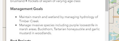

ZachBodenner
MVP Regular Contributor
Both of these work great! I'm going with @BlakeTerhune  for this particular solution - I'm not exactly sure why but my split was resulting in the first split result (sMgmt[0]) being an empty value, and this code structure gets around it (possibly because of the Trim function?). The result looks pretty good!
