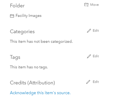

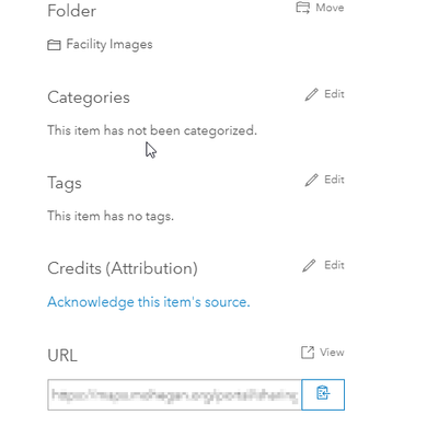

Yes, it would and that's exactly what I am looking to accomplish however when you set the permissions to Organization, The link is no longer available.
Shared Publicly:
Shared to Org:
