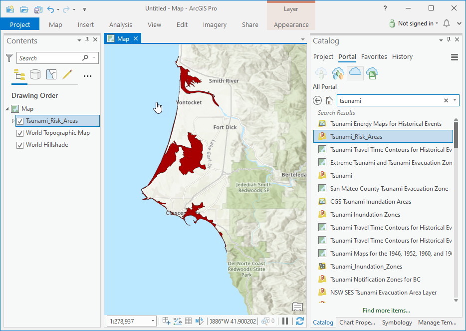

Nope, no ArcGIS Pro in my original post.  I just tested your desire successfully in ArcGIS Pro 2.4.2.  Here's what I did:
  • ArcGIS Pro 2.4.2 > "Project" tab > "Portals" > "Add Portal" > https://www.arcgis.com
    • resulted in "https://www.arcgis.com, Available : Not signed in" being listed under Portals
  • Right-clicked that portal entry > Set As Active Portal
  • View > Catalog Pane > Portal > clicked the "All Portal" cloud thingy > searched "tsunami"
  • got a bunch of results and added one to a map
  • woot
ArcGIS Pro searches ArcGIS Online
cheers,
tim

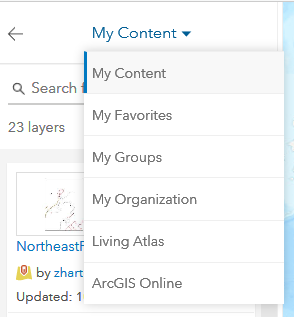

Right. So you have to switch back and forth from AGO to your Enterprise Portal for each search, right?
Which is odd because when you're in the map viewer in Portal you can choose either from the drop down.

Users seem to be confused because in Portal they can search for Portal items & ArcGIS Online items intuitively.
(Presuming you've configured your enterprise site to allow ArcGIS Online content of course).
In Pro you need to log out of Portal and log into ArcGIS Online. This presumes all of your user base has an ArcGIS Online account in addition to their Portal accounts, whereas in the Portal configuration this is not necessary.
