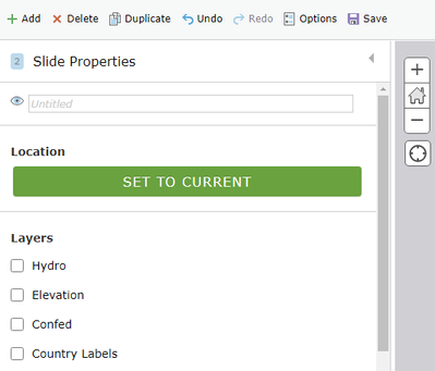

My partial resolution was to create a 'Presentation' from the Web Map. The Presentation feature enabled me to toggle on/off layers and save each view as a 'slide' - see screenshot. I then embedded this presentation slide into ExB using the Embed Widget with URL Parameters, as per below.
<domain>/arcgis/apps/presentation/index.html?webmap=<id_goes_here>&slide=1
BUT, the Presentation App retains the original drawing order (or TOC order) of the Web Map and does not provide the option to reorder layers. Reordering layers in the original map might display one slide well, but impedes display of another slide, as some feature layers become hidden behind others. Essentially, each slide needs its own drawing order.

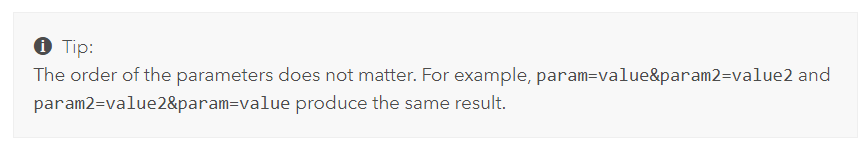

Thanks for your message. My understanding is that URL Parameters can toggle on/off the layer visibility, but the drawing order remains the same as in the original Web Map? That's my impression from the snippet below.
https://doc.arcgis.com/en/dashboards/create-and-share/url-parameters.htm
