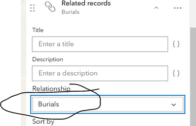

Yes, you do want editing enabled.

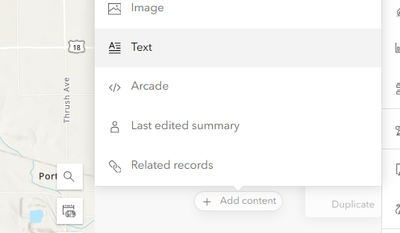

So when you click "add content" under the popup this doesn't show?
You'll have to click your table under relationship after you click related records here.
