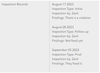

My problem is, the popupString stops returning attribute values after the fourth attribute (in this case, "f.Findings".
Here is a screenshot of the result:
I've tested this by re-ordering the attributes returned in the popupString, and when I do that, the reordering holds true but still stops at that fourth field. This tells me that's it's not likely that the code is just...stopping? truncating? at some kind of error in the code (no errors thrown when testing).
Any ideas?

You have an extra "TextFormatting.NewLine" in each of the lines from "Findings" onward
        "Inspection by: " +
        DefaultValue(f.InspBy, '') + TextFormatting.NewLine +
        "Findings: " +
        DefaultValue(f.Findings, '') + TextFormatting.NewLine +
        TextFormatting.NewLine // remove this
 Since they don't have a "+" after them, those lines are not added

ZachBodenner
MVP Regular Contributor
Wow it's kind of amazing how our eyes can pass over some things. Thanks or catching that!
