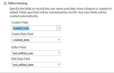

From what I can see, the Editor and EditDate are older fields that are no longer applied to newer layers. To fix that, you'll need to either create the fields "last_edited_date" or similar, and then use the manage function to change which fields the editor tracking is written to:

Thanks for the quick response!  The EditDate and Editor field are appearing on layers published today, so I don't think it's purely age-related.
