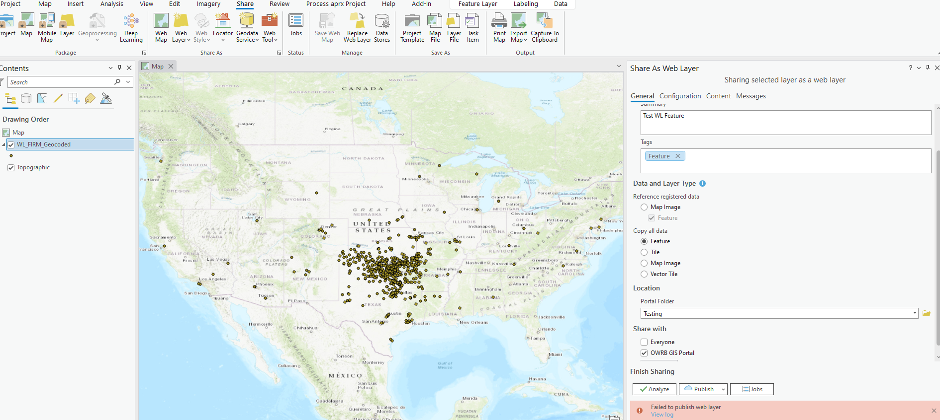

I have been trying to publish a web feature layer for the last 24hours and I can not get ArcGIS Pro to publish it as a feature layer without failing, I have been able to publish it a vector tile layer but that does let users gain access to the attributes of the file which is very import.  I have looked up the error and it's a generic one but I have tried all the solutions and none of them have worked. I should add that the version of ArcGIS Server is 10.6

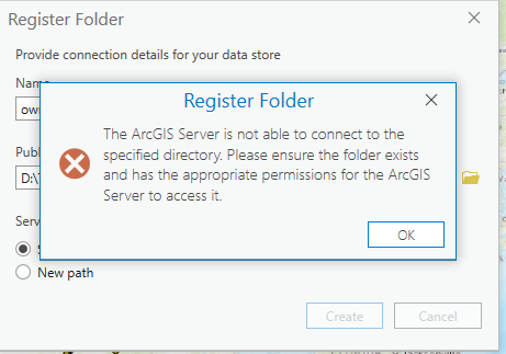

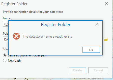

I have also tried to use the Reference registered data with "map image and Feature" selected the analyze gives me the message that the layers data source must be registered with the server, when I try this and provide the connection details, which I figure is just the datastore name it needs it says this folder doesn't exist, or I will get the datastore name already exists... So it's kind of confusing.
  I have done the routine starting and stopping of the services and even rebooted the server to clear out any issues I have validated all datastores and corresponding folders.  I am not sure what I am missing something important in this process that is preventing me from publishing this layer?  I have provided a log of the failed publishing and a screen shot of the how it is setup from ArcGIS Pro.

It's hard to work out from the screen grab which ones of those are working/not working for you.  can you expand please?

Sorry I was maybe to vague, I am trying to create a complete copied feature service layer from the data in the fgdb to the hosting server where I am sending all the data from the fgdb to the managed database, I have successfully done this with Vector Tile and the Map Image options, but when I try to do it with the Feature Layer type it fails and yes all of the managed data bases do validate I have checked inside of ArcGIS Pro and on the ArcGIS server itself to make sure the Validation of those databases are successful.  I am not sure what the next steps I should take?

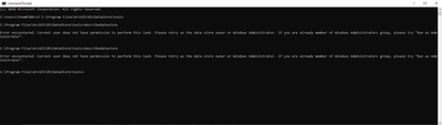

But before you do that can you got to the machine with the data store and run a command line?  You need to navigate to the data store install folder, e.g.:
   C:\program files\arcgis\datastore\tools (or wherever it was installed)
the run the describedatastore command line.  Send a screen grab, but obfuscate any server/file share info.  I'm wanting to know if it's in readwrite mode.  It could still validated but be in readonly.

KThomasson
I get an error as shown in the screen grab
