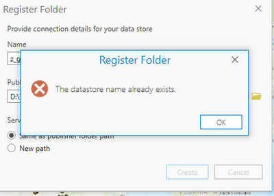

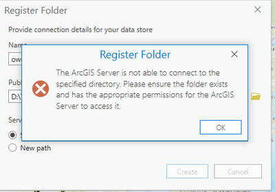

I have also tried to use the Reference registered data with "map image and Feature" selected the analyze gives me the message that the layers data source must be registered with the server, when I try this and provide the connection details, which I figure is just the datastore name it needs it says this folder doesn't exist, or I will get the datastore name already exists... So it's kind of confusing.

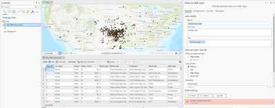

KThomasson
this is my setup when I get the failure.  I should also point out that even though it fails to publish the feature layer it does publish the service definition of that service to the portal site.

The service account running ArcGIS Server requires at least read access to the area you're trying to register with the server.
An alternative would be to copy/cut your file geodatabase to the Server itself e.g. to \\ArcGISServer\D$\Filegeodatabase
Then, if you have a folder in D:\Filegeodatabase on your machine - you can then use the "Use same as publisher path" when registering the data source. Please keep in mind the data will have to be updated in this location.
