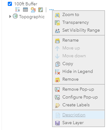

I am unable to locate a layer that one of my users added from file (zipped .shp) to a web map. The layer is functioning as expected, but my concern is that the file does not show up in the Content/My Organization tab. I also checked server manager and it is not showing up there either. I added an item myself in the same manner and it is the same... I can only find the item as a layer in my saved web map, and there is no link to the items details. I understand that I can save this item as a layer and it will show up in the content tabs, but this isn't my concern. Ultimately, I am concerned that my users may be able to store information on my system that I am unable to locate and/or manage.
Does it get stored in the Web Map only somehow?
jcarlson
MVP Esteemed Contributor
Adding a layer to a map is not the same as adding it from the My Content page. Until you click Save Layer, it is, in fact, being stored in your web map's JSON.
