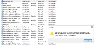

I am doing an in-place ArcGIS Upgrade from 10.9.1 to 11.1.
After successfully running the portal upgrade installation, clicking "Finish" button to close the Installation Wizard. As I am expecting the browser takes me to "Import License Files" page, just found out that the Portal for ArcGIS Service has stopped, and the service account was somehow switched to "Local System Account"
When trying to start the portal service manually, it throws the error message saying "The Portal for ArcGIS service on Local Computer started and then stopped. Some services stop automatically if they are not in use by other services or programs.".
Tried both GMSA and local service account to run the upgrade, still get the same issue, hence cannot start the Portal for ArcGIS service and cannot reach the https://**:7443/arcgis page.
For your context, the ArcGIS Enterprise is hosted on Azure, and the portal content directory is Azure Storage. We have another DEV environment with same deployment pattern, but no such an issue with the Upgrade.
Can anyone share some thoughts or have experienced such issue before?

A_Wyn_Jones
Hi @anbinh,
Did you have issues applying patches to Portal at version 10.9.1? The message you're seeing indicates a corrupted Portal installation.
Please roll back your deployment to the latest snapshot at 10.9.1 - when you've got back to 10.9.1, please take a WebGISDr export of your deployment to ensure your data is not lost.
I'd suggest you open a support ticket with Esri as soon as possible.
Personally, I have seen this happen a few times lately, with conditions unknown as to what causes it.
The fix for me was to uninstall Enterprise at version 10.9.1, clean windows registry relating to ArcGIS Enterprise, reinstall ArcGIS Enterprise 10.9.1, fully patch it and then import WebGISDr.
In my instance, a patch would refuse to install. Once the system was rebuilt the patch could be installed successfully and the following upgrade to 11.1 was successful.

Here is an update:
I have partially taken @A_Wyn_Jones 's advice, rolled back to the portal at 10.9.1. Taking a step back, we have tried to apply patches to the 10.9.1 portal. However, just similar as Wyn's experience, the patch was seemingly successfully installed (installation wizard completed its run), but the patch was actually not installed. The patch cannot be found from "Installed Patches" listed in the patch notification wizard, neither can be found from "Installed Updates" in the Control Panel.
The failure of patching may be very related with the failure of Upgrade. Both involves installation and certain permission, and both installation wizard finished its progress in my case. Just that patch was not applied, or upgrade messed up the portal.
I have reached out to both system team to investigate the system such as group policy setting, and Esri Support to further investigate the application.
