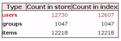

after upgrading the AGE environment we've got the issue that the Portal index couldn't be rebuild.
You can see in the pic above that 123 users are missing. We cannot find them in the Portal UI.
After executing the reindex, the log shows the following:
