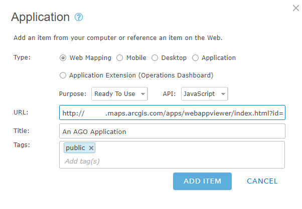

I wanted to create an Application Item in Portal that points to an application in my ArcGIS Online Organizational account using a URL like http://myorg.maps.arcgis.com/apps/webappviewer/index.html?id=1fe52f64640247c99c772de938809f7a
Application Item Dialog in Portal 10.5

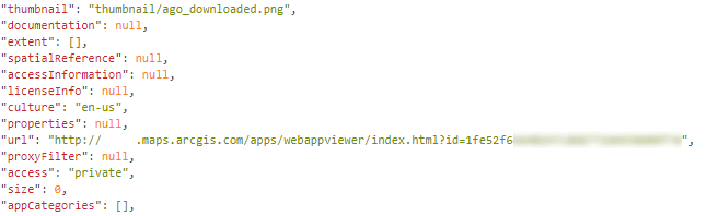

If I look at the item's JSON data in AGO Assistant, the correct URL is present. So it appears to be a bug in the Home application where the URL is being interpreted and transformed into an local Portal URL.
JSON Data of Portal Application Item with Correct URL
