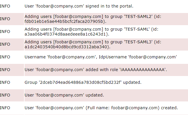

Following your recommandation, I enabled logging to debug mode and created to 2 groups 'TEST-SAML' and 'TEST-SAML2' configured as member of the organization group 'gis-esriportal' and tried to log in with an account not initialized on ArcGIS Enterprise and member of the group 'gis-esriportal':
SignInDebug
As you can see the user 'foobar' is correctly added to the groups 'TEST-SAML' and 'TEST-SAML2' as it is a member of 'gis-esriportal'.
