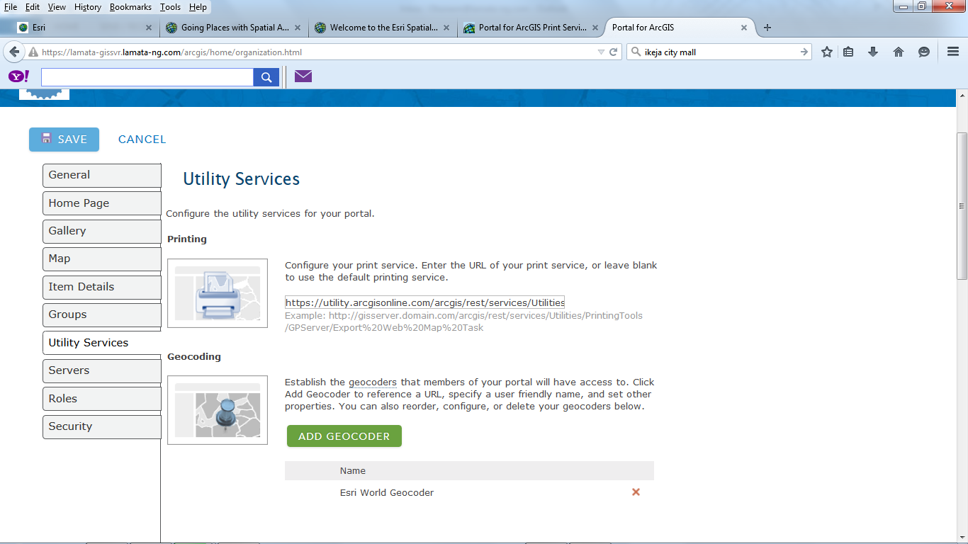

Hello,
I'm stuck and need major help. In configuring my Utility Services, I am unable to replace the default print service Task: Export Web Map Task with my preferred, tried and tested print service http://lamata-gissvr:6080/arcgis/rest/services/Utilities/PrintingTools/GPServer/Export%20Web%20Map%2...
I know it has something to do with secured services, but not really sure what. The default service is https://  while the one I want to replace it with is http://
What should I do?
Someone help please!

Lara,
   What is the context of your question? Are you working in some in some web API like javascript, a map template, etc? If you are working in Portal as your other question is then portal requires you to use https.

Hi Robert,
Thanks for your reply. I am working in Portal and it has occurred to me that the utility service will only accept https. That being the case, can you please help me understand what I need to do to get a better print service up and running for my users. The default service (Task: Export Web Map Task​) is ineffectual, I need something better. I was able to configure a print service for my flex application which worked fine. I thought i could use that same service in Portal, but to know avail, because it is http.
This is the default service I would like to change.

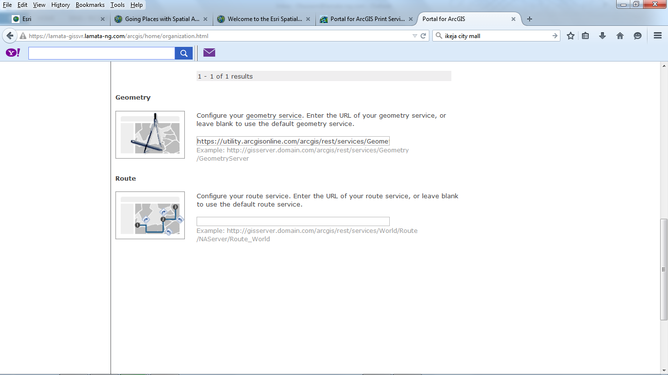

I would also like to setup my route service.
Please help!

Lara,
   Do you remember the process you went thought to get your portal to use https? well you have to do the same with your ArcGIS Server services.
