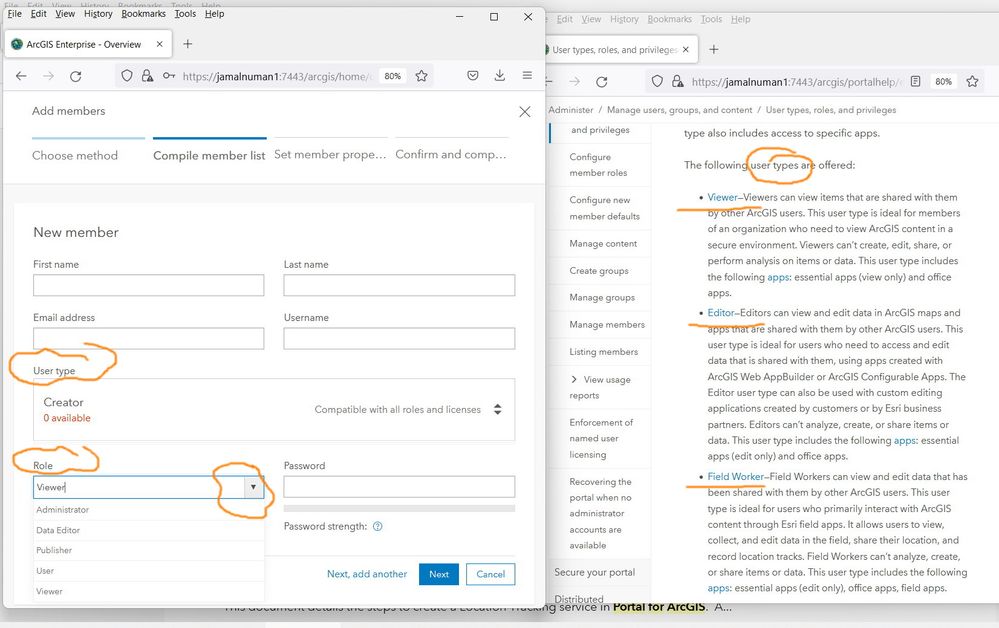

I couldn’t figure out why there is no drop-down menu for the “user type” the same way it’s available for the “role”.

My point here is that the “user type” field could have a drop-down menu for the possible values (creator, viewer, etc.) while the role (dependent field) could have the corresponding possible values based on the value of the “user type” field
This is much more decent than the current design

The "User Type" is a dropdown, but it's based on what user types are licensed in Portal for ArcGIS. If there are only Creators licensed, the dropdown won't show anything else.
The Role dropdown does correspond to the user type selected. In this case a Creator user can have any of the available roles, which is why you are seeing them all present.
