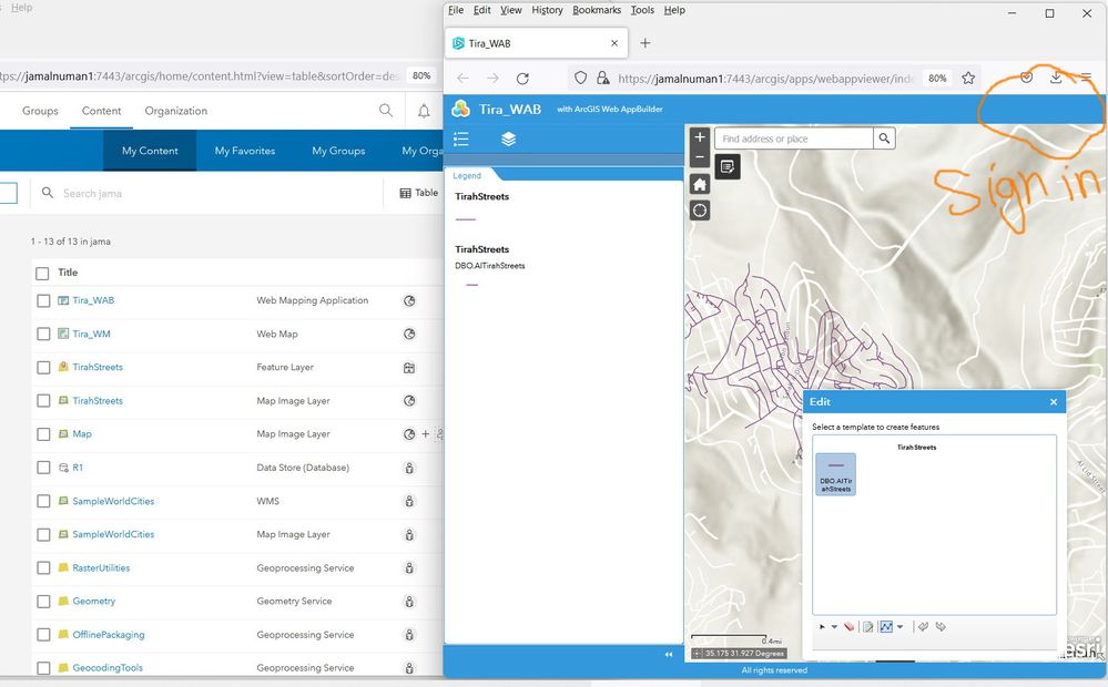

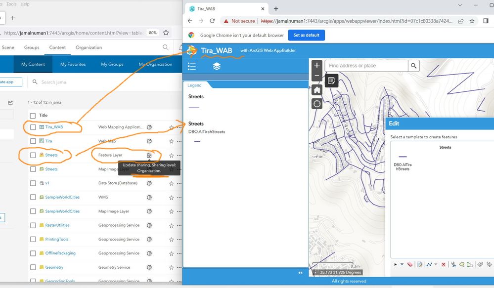

I wanted a member to be able to edit a particular feature service (that’s with organization group permission) and consumed in WAB with everyone (public) permission.
How this can be implemented?

Since your WAB app is shared out to Everyone then it isn't forcing the login window.  Your options would be:
1. Share your WAB app to organization only to force the login window.  It appears you have the feature layer added to your web map and since that layer is shared only to your organization if I person is not logged in then it shouldn't even open that service.  Try opening the WAB app in incognito mode and see what kind of result you get to see if it is functioning correctly as you desire for an Everyone user.
2.  Have two WAB apps,  one for Everyone viewing and one for Editing.  The Everyone wouldn't have the edit widget and you can just add the map service layer and the Editing one would have the Edit Widget and feature layer added to the map along with the sharing properties would be just the group your desired editor is in.
