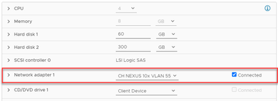

@JonathanQuinn FYI - I also ran into this same issue and the same log messages in my 10.7.1 Enterprise. Recreating the index service didn't fix it. The issue for me was that my Portal VM's network adapter somehow became disconnected (unchecked) in vSphere. Once this was re-checked, the issue was resolved:
