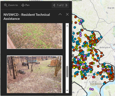

Dashboard in portal 10.9.1 is no longer showing image attachment thumbnails now that the data has been migrated from a hosted feature layer to a federated service published from SQL database. Clicking the image name opens the image in a new window as it should, but thumbnail previews are now gone. Newly added features and attachments have the same issue. Is there a way to generate previews in the db feature class or otherwise get them back in the popup? Any help is appreciated.

I'm using the popup from the web map but the details widget doesn't display thumbnails either. This was ENH-000152177 which was closed on 3/20/23 as it is implemented in enterprise 11.1.

Thanks for pointing this out. Since migrating to 11.1, I'm no longer seeing this issue, but I'll keep my eye out for images that do not display a thumbnail in the popup. I can at least look into compression if they don't work.
