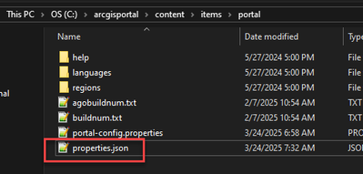

Thanks for the reply.  The properties.json file was in the \arcgisportal\content\items\portal directory as the other commenter had suggested.

Hi @LeoFothergillMTA,
Check if there is a properties.json file in the \arcgisportal\content\items\portal directory.
LeoFothergillMTA
Jake, yes there is a properties.json file in that location.
