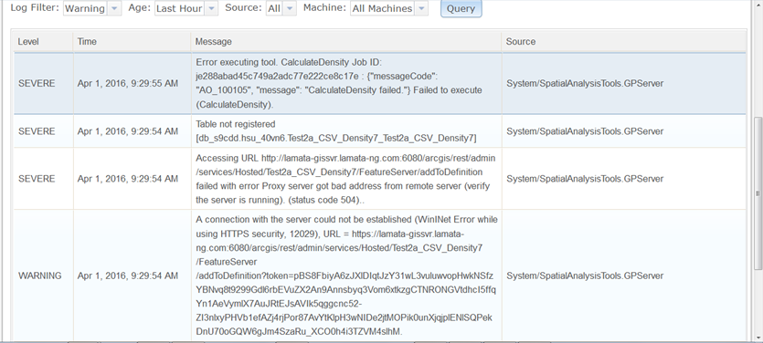

ShaneApplegate
Were you able to find a solution to this issue? I'm facing the same problem where the CalculateDensity analysis will return "CalculateDensity Failed" with almost no other information. It also has the message code AO_100105.
I turned the logs on to debug and did not see anything of use. Basically just the traffic of creating the service, updating the service, and then deleting the service. Couldn't find any sort of errors or explanation why the analysis was failing
The strange thing is that I can get most of the other analysis tools to work it is just CalculateDensity that has been giving us trouble
AlexLeonov
This error is because of insufficient license level of ArcGIS Server. This tool using Spatial Analyst capabilities and so the ArcGIS Server Advanced license needed
It will be great if esri will inform about such errors by more informative messages)
