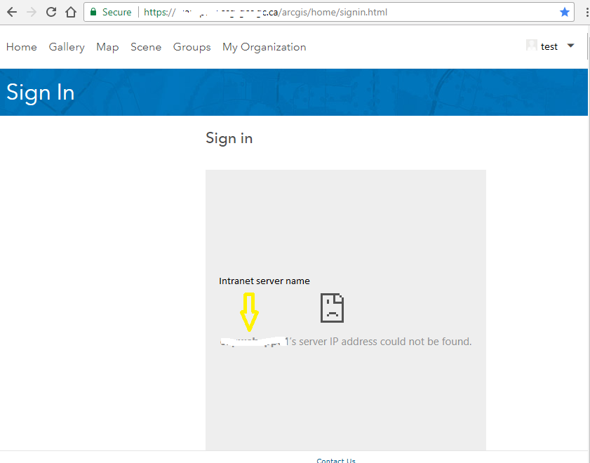

2. After user signs in, if user reloads the signin link: https://public-url/arcgis/home/signin.html,   the following page is shown, where, in the middle of the page, the intranet server name is displayed again:
Could somebody shed lights on the above two issues: how to change IIS rewrite rules to hide the intranet server name in the above two cases and display the public domain name correctly? I notice that one of issues is related to form, and the other one is related to IFrame. The strange thing is that the public domain name is loaded correctly in other parts of the public Portal for ArcGIS.
