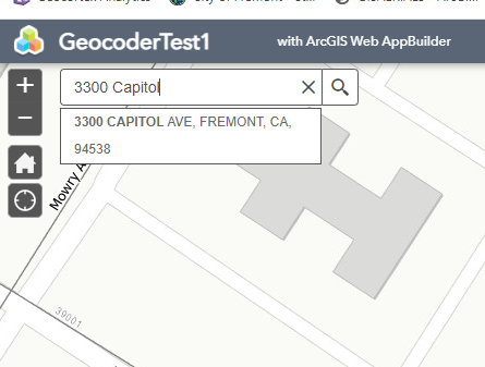

When I type in an address. in the search window of the web map app for example: 3300 Capitol Ave, it only returns 3300 Capitol Ave; but 3300 Capitol Ave also includes 3 addresses with a subaddress as follows:
3300 Capitol Ave, Bldg A
3300 Capitol Ave, Bldg B
3300 Capitol Ave, Bldg C
How can I get the Locator or Search Widget to show a drop down of all the suggestions that would include:
3300 Capitol Ave
How can I have the Locator show the above list of 3300 Capitol Ave addresses in the drop down shown above?

I think there seems to be an issue with Locator suggestions across the board. In 10.6.1 I am able to type an address and get a list of suggestions, but in 10.9.1 (with Locators created in Pro 2.9 Patch 12) I type an address and get no suggestions in the drop down as I show in my 1st post of this thread. Even if I have the "Suggest" and "Partial Suggestions" boxes checked they seem not to do anything. I was under the assumption that geocoding with suggestions enabled would be the same or improved since 10.6.1 but this does not seem to be the case.

In Pro 3.1.4 - Map - Find Address, I get the expected behavior with suggestions being seen in the drop down after an address is typed, but when I publish the Locator to 10.9.1 and do the same in a web map in Portal or AGOL I get no suggestions in the down. Let's hope maybe someone from ESRI will chime in on this thread with a solution.
I cannot understand why the Locator gives the expected results with suggestions in Pro but not Portal or AGOL in my case.
