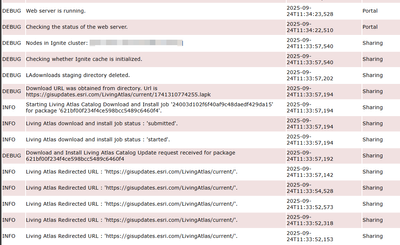

cdevault_pickett
@DavidColey Did you have any luck with this? I noticed that my scheduled updates were not working and showed nothing in the logs. I tried a manual update and received this error.
After checking my logs I found nothing and switched my logging to debug mode and tried again. Got the same error and found this in the portal logs.
I have checked firewall configurations based on this article and that does not seem to be the issue.
