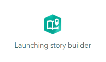

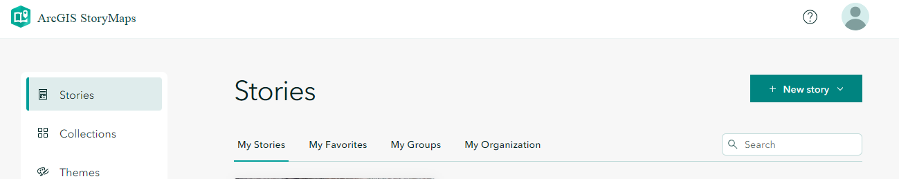

When users click on the waffle to create a StoryMap they are directed to this page:
Clicking on the New Story button > start from scratch - results in the program hanging, with the following displayed:
I am an administrator and am also experiencing the same, so it is not a privileges issue as some posts online suggest. What would you suggest?

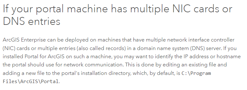

Leo_Liu_WA
If CORS related, sounds this 'add new item' post request is using a different host name as the portal you signed in?
Is that an alias issue? For example, you sign in your portal with a meaningful alias of your portal server but internally the portal utilises a different or original server name as host.
If that is the case, try this one:
Installing Portal for ArcGIS—ArcGIS Enterprise | Documentation for ArcGIS Enterprise
Config DNS for PortalConfig DNS for Portal
