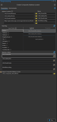

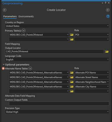

MichaelBouvet
Jayanta helping me out again! hahaha.
I remember in desktop there was always an "Enable suggestions" check box when creating locators, but I think in Pro that is just included by default:

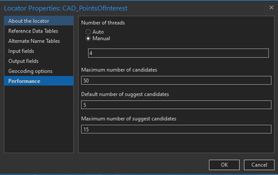

There's no where to enable suggestions; furthermore the properties of the locators seem to indicate they support suggestions by default:
