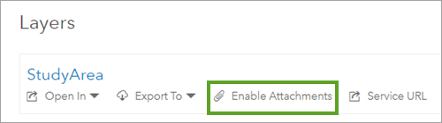

It's a little frustrating as all of the ESRI help just says "click the Enable attachments button" but doesn't say what to do if there isn't an enable attachments button.
What ESRI wants me to do:
ESRI instructions

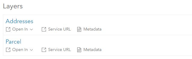

What I see:
What I see

The documentation is referring to a hosted feature layer, meaning the data is copied to the ArcGIS Data Store.  Because you're using a feature service that references the registered enterprise geodatabase, this option isn't available within the ArcGIS Enterprise portal because available because the administration needs to take place within the RDBMS itself.
With this in mind, attachments enabled on the feature class will be respected in the feature service - so you should be good to go with your workflow in Collector.
