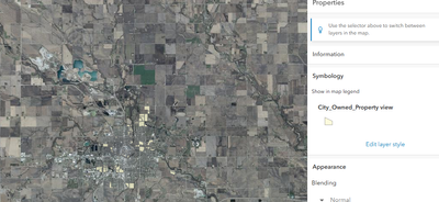

Here is what my view layer looked like in the map to begin with:
After editing in Pro and saving as a web layer it now looks like this:
Right click on the layer in Pro - Sharing - Save web layer
https://pro.arcgis.com/en/pro-app/latest/help/sharing/overview/save-a-web-feature-layer.htm
