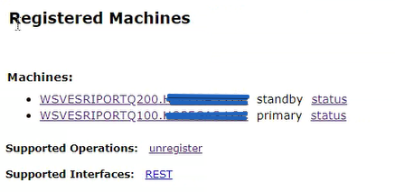

We have setup an HA Portal configuration and cannot get the standby Portal to pass the health check.  Keeping getting an error that the /sharing/rest endpoint cannot be reached.  In /portaladmin/machines the machine is listed and shows as standby:

We have restarted, rebooted, and even re-installed on the problem persists.  We have turned off domain firewall to see if it might be a firewall issue.  The machine is part of a Windows cluster, but don't think that should cause a problem.
