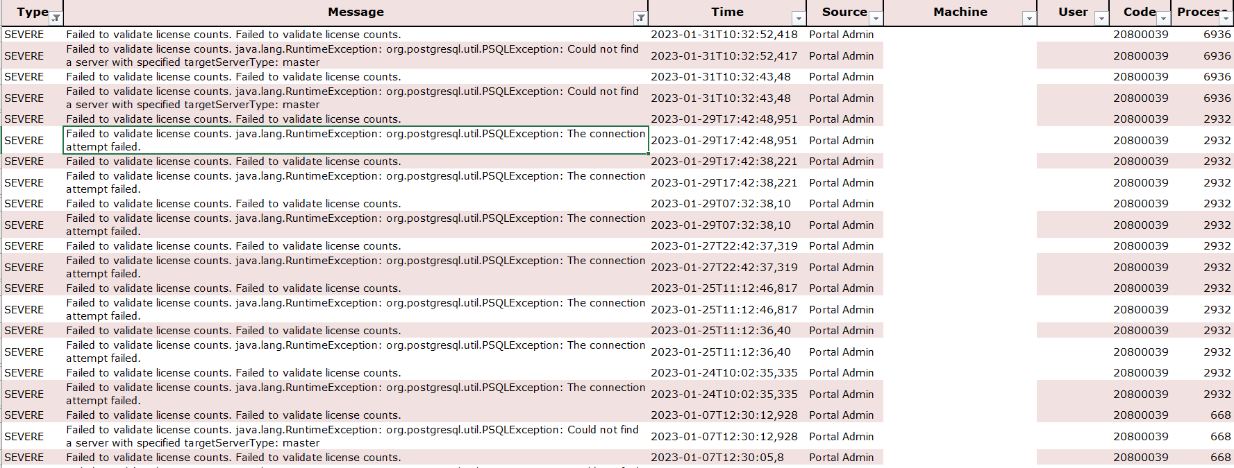

ArcGIS Enterprise 10.8.1, HA, Multi-machine Deployment, Getting below SEVERE messages randomly from portal machines.
Failed to validate license counts. Failed to validate license counts.
Failed to validate license counts. java.lang.RuntimeException: org.postgresql.util.PSQLException: Could not find a server with specified targetServerType: master
Failed to validate license counts. java.lang.RuntimeException: org.postgresql.util.PSQLException: The connection attempt failed.
Did anyone observe this in 10.8/10.8.1? What could cause this? Any suggestions Please?
