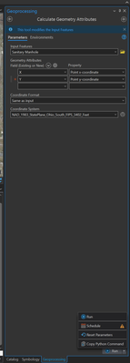

There is a tool called Calculate Geometry Attributes that I find useful, this allows me to update/populate x,y and z values to fields I have created in the Feature Service. You can definitely take this data and create a table from it.
I use it two ways:
First way- is having a layer with fields where you want the data stored, then pull up the Calculate Geometry Attributes tool. Make sure your layer is in an ArcGIS Pro project then add it and set your fields and properties for which values are being calculated. I run this daily using scheduler on ArcGIS Pro but you can run it once too.
