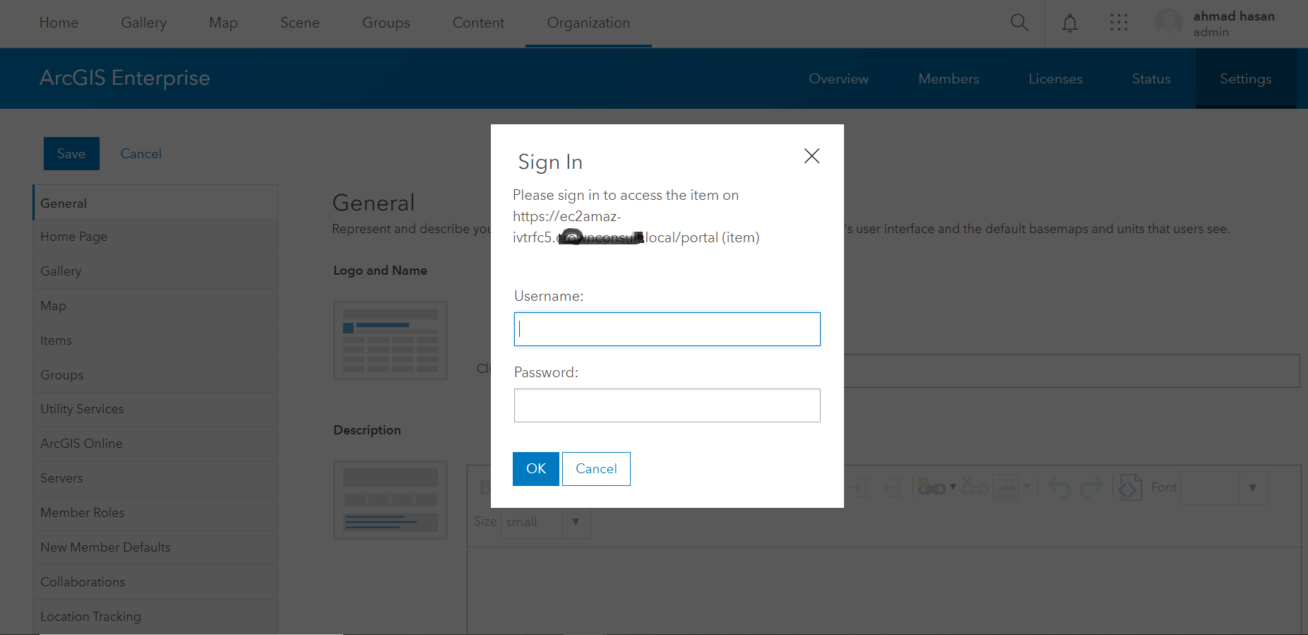

I have ArcGIS server and ArcGIS portal with 2 web adapter for each of them, before i added ArcGIS server  to ArcGIS portal i was able to access ArcGIS portal from public address ,when I added ArcGIS server to act as hosted server to ArcGIS portal, i tried to login to ArcGIS portal and the login page was pointed to local server address, before it was pointing to the public address, the question is how to make ArcGIS portal authentication service pointing to the public address ?
this behavior happening only when ArcGIS portal communicate with ArcGIS server to get any resources, otherwise i can access login to ArcGIS server without any issues

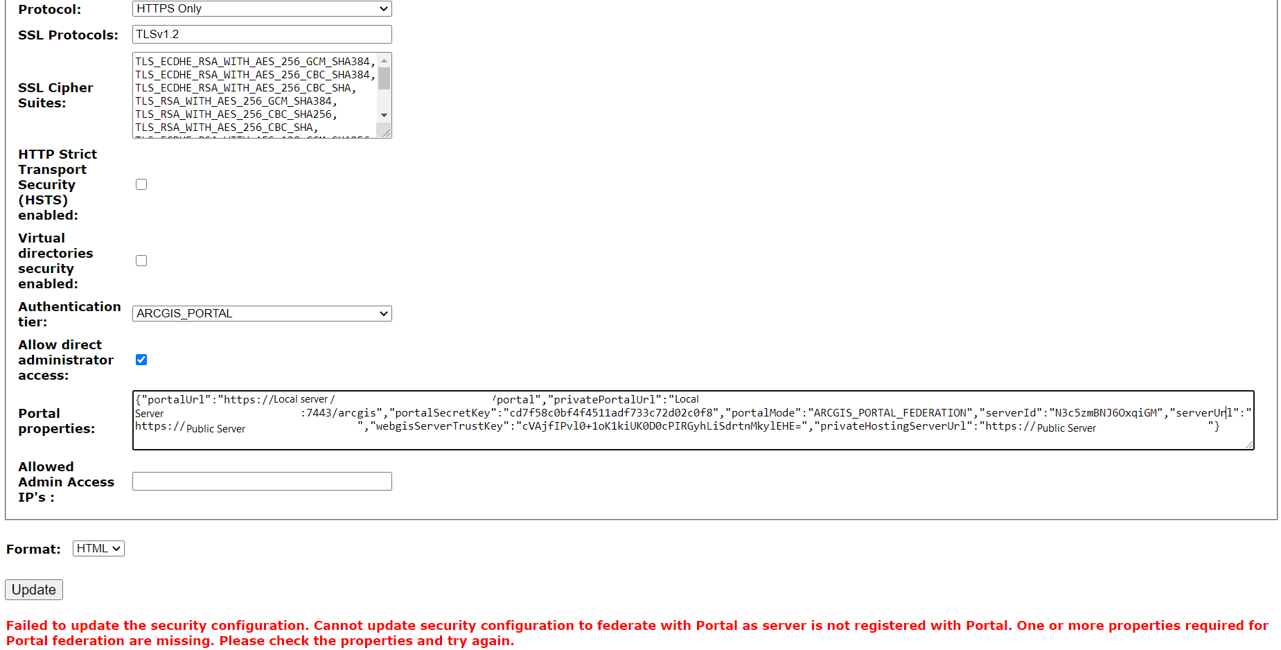

I did this , i used that link before and it didn't solve the issue, i can see in the ArcGIS portal in the servers setting it is pointing to the public address but when i go ArcGIS Server admin in the /arcgis/admin/security/config i can see the following parameters in the portal properties :
  • portalUrl : pointing to local server
  • PrivatePortalUrl: "https://localaddress:7443/arcgis "
  • "portalMode": "ARCGIS_PORTAL_FEDERATION",
    "serverId": "",
    "serverUrl": Pointing to Public Address
    "privateHostingServerUrl": "https://Localaddress:6443/arcgis"
