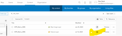

Feature Service shows that it is share to organization but it is shared to everyone. My data is not secure. Portal indicates that it is secure.
793
05-02-2025 02:46 PM
DanielStark

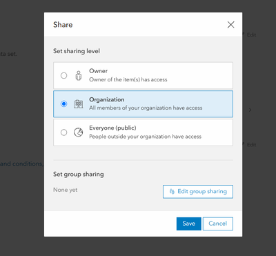

This shows that my feature service is shared to the organization. When examining the REST endpoint, it is shared to everybody. This is a massive security flaw.

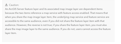

Unfortunately, this is working as designed. Sharing doesn't respect when the map image layer item and feature layer items are different. All "additional" functionalities inherit the permissions for the map service (map image layer). Here's a couple of posts with more details. A custom SOI (https://developers.arcgis.com/enterprise-sdk/guide/net/what-is-an-soi-net/) can provide this functionality and much more but is a bit complicated to implement.
https://community.esri.com/t5/arcgis-enterprise-ideas/allow-map-image-services-and-feature-services/...
https://community.esri.com/t5/arcgis-enterprise-ideas/ensure-security-settings-are-enforced-across-a...
