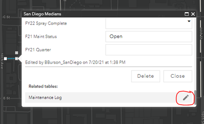

If you click the feature and scroll down, you should see the related table at the bottom, with a pencil icon:

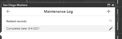

And after clicking that, you should see a plus icon to add a record to the related table:
And when finished you should see the new record/row:
If you don't see this, perhaps the layer or widget is not configured correctly. But at least knowing it is possible here should help. These screenshots are from ArcGIS Online Web App Builder, using a hosted feature layer published with the related table from ArcGIS Pro. Hope this helps!
