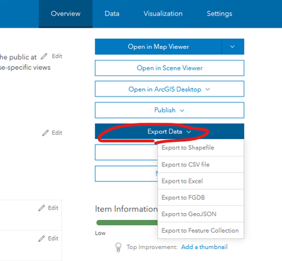

Unlike Hub, in Sites, that Download button is akin to this one:
If you've used that button, you know it doesn't download the selected filetype directly, but rather creates a separate content item in your folder, which you can then download. Because of this, the Download button on a Portal Site requires that the user be both logged in and have sufficient privileges to own content items.
I'd guess that there's something different going on under the hood in Hub that makes the direct download possible there.
If it's any consolation, those of us who prefer Hosted Features Layers are in the same boat here, so switching to hosted would not fix this issue for you. From Portal, the only way to allow users to directly download a layer from a content item is if it is the file itself.
Which, of course, would require you to keep a regularly updated copy of the file available as its own separate content item. And that feels like a step backwards, honestly.
