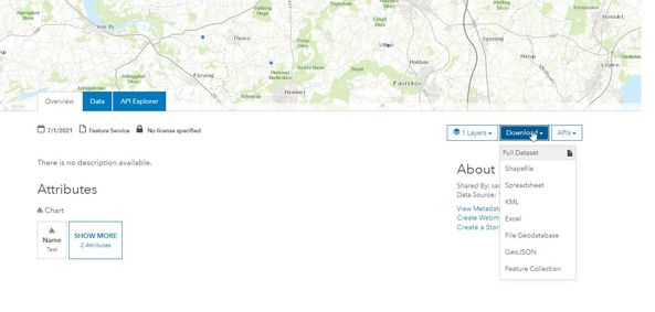

The below image is what I want:
What I wantWhat I want

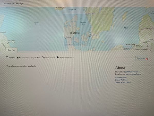

This Is what I have:
What I haveWhat I have

We ran into this issue as well. As far as I can tell, clicking that button is equivalent to the "Export Data" button in the Portal:
If you've ever clicked one of those options, you'll know it doesn't actually download the data directly. Rather, it creates a new item in your portal, and that is what you can then download.
The heart of the issue is that in order for that export / download to work, the user doing so must have the authority to own content items in your portal. If their user type doesn't include that right, or they're an anonymous visitor to your Site, then the "Download" button isn't going to work for them.
