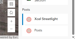

Alright I have an update on this workflow. I created a new Preset Template using two point features from different feature classes and stored it in the geodatabase using the Store Templates command. The results are mixed:
Pro: immediately was recognized by the published web service
Cons: The two features in question are related feature classes and that seems to introduce some unexpected/ unhelpful behavior.
1) in the web environment, the template does not make it clear that the child feature would also be created. Here's a screenshot from Web Editor
We should expect, I would think, something like this, where both point features are represented?
Either way, I can't test out to see because I get an error immediately when trying to create the feature
2) The best practice of course would be that the template would also create that desired relationship. That was also unsuccessful, as the parent (Post) Global was mismatched with the child (Streetlight) GUID. Interestingly, I have an attribute rule running on these features where the child feature will receive the unique ID from the parent based on the GlobalID-to-GUID match. Using the template, that attribute rule actually ran successfully even though the features appear unrelated otherwise (again, all different GlobalIDs and GUIDs). That one's a bit of a stumper to me.
Finally, I can't seem to find any documentation on simply deleting the written templates from the database. The article and linked ESRI documentation points out how to overwrite templates with the same name and delete templates that don't have a matched name when attempting subsequent Store Template commands. What I want to do is simply delete this template that I just created without having to write others at the same time.
