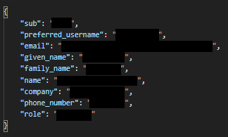

This is the response format that the identity provider returns from the user info endpoint

This will probably not help you directly, but I have a customer who were able to setup KeyCloak with ArcGIS Portal 10.9, but I do not have any details on the configuration. But when I was setting up the Okta setup, I also struggled with this error. I ended up with not checking the "Send access token in header", setting the  UserInfo URL to empty but filling out the JWKS url. With the Okta configuration I uses Client Credential and Authorization Code. I also had to make sure the Claims where mapping correctly. I also have a sub claim added.
pocalipse
I think my problem is exactly the mapping - did you manage to figure out what claims ArcGIS is expecting?
