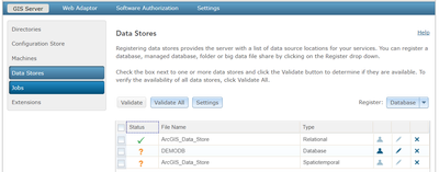

First, check if you are able to validate the Relational Data Store (ArcGIS Server Manager > Site > GIS Server > Data Stores).
If it doesn't validate successfully, you need to address the issue with the data store first.
If the data store gets validated successfully, you may proceed to designate a federated server as the hosting server.

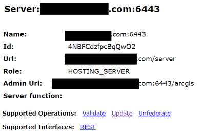

First try using the Portal GUI (Organization->Settings->Servers).
Else use PortalAdmin page (Federation > Servers > Click on Server's link > Update) to designate a federated server as "Hosting Server". Designating a Federated Server as a Hosting Server, doesn't unfederate it.
This is how our federated (and Hosting) Server looks from PortalAdmin page.

Do you have a relational ArcGIS Data Store configured  with the GIS Server?  MichaelVolz_0-1625055886187.png
