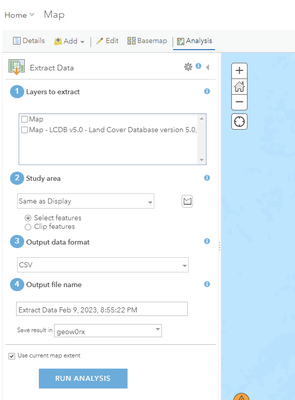

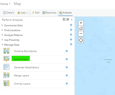

So you've massively peaked my interest here.  I've worked through some client portals who have Export Data/Sync successfully enabled and used in Distributed Collaborations.  From a registered geodatabase there is no export data source against the item.  Nothing.
I've also reviewed it in my own development environment and can confirm that the function is 'missing'.  It looks like it's only available on hosted feature layers.
When you try and export data from ArcGIS Pro, it makes no difference if export is enabled or not.
However, where the capability does make a difference is in the Analysis Tools in Map Viewer Classic.  If it's not enabled then you cannot export, but turn it on and you get this:
the highlighted option is greyed out if the export data capability is disabled.
So I think the issue you describe is by design.
