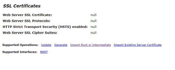

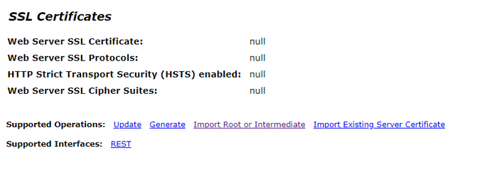

  • In D:\arcgisportal for both servers, we have extra folders with name e.g. db1606979894714
  • When we click on the ssl certificates for the standby machine, all the values are null
  • The links to generate tokens for the standby machine (sometimes for both machines!) is not accessible with error 404 e.g. https://standbymachine.domain.com:7443/arcgis/sharing/rest/generateToken. In general the arcgis/sharing/rest is not accessible.
  • We cannot connect to the portaladmin, using the url ...:7443/arcgis/portaladmin with error message: You are not authorized to use this resource.
