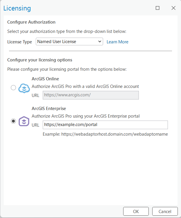

At first let me describe the case when Pro can start successfully: when Pro is started from a Windows PC with licensing configuration as below.
And next case, for some test we need to install ArcGIS Pro on the same server machine with the Portal. However when I start Pro on this machine the authentication just shows an authentication waiting screen. The authentication step is not finished and ArcGIS Pro does not show its menu screen.
