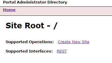

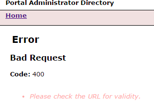

Hey Thomas,
thanks for your suggestions, I currently get to this page,
but when I create a new site, it points me to this
I am not sure what the issue is, I have authorized portal, etc...
if you have any suggestions let me know,
ThomasPitchford
Deactivated User
My only suggestion would be to look at the URL string. We were getting the 400/Bad Request error as well until we modified the adaptor URL from my post above to point to the IP address instead of the name.
There is a chance this could be a certificate issue on your IIS server.
