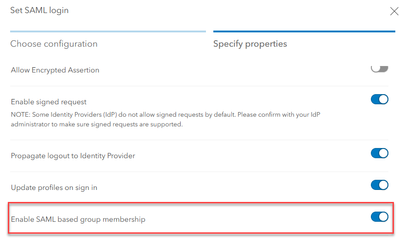

2.  Allow automatic account creation for SAML logins
3.  Enable SAML based group membership within Enterprise

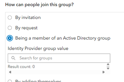

4.  Create a SAML based group in Enterprise
5.  Share the secure services to this Group
When a user accesses the Dashboard, they will be prompted for credentials to access the secure services.  If they do not have an account, their account will be created automatically in Enterprise.  If their Azure AD account is part of the SAML based group the services are shared to, they will have access to the Dashboard.
